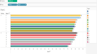

Thanks, that worked to get me the view, but last thing, can I adjust bar colors based on a column. Particularly the Region color in this dummy data?
Please provide sample data that fully covers your issue.
The smaple data does fully cover what i'm trying to do. with that sample data i was able to build this visual in Tableau. I'd like to get the same viz in Power BI
Ah so you want random colors? Why?
becasue next to this chart I have a map view and the 1,2,3, etc. are mapped to certain regions/states. So I want users to be able to look at the map view and see ok yellow here is region 4 and that yellow maps over to the bar chart
