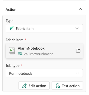

so when you choose a fabric item in action part there is nmp option for input field
like in the input fields, i need to add this part
  "deviceId": "{{deviceId}}",
  "temperature": "{{temperature}}",
  "timestamp": "{{timestamp}}",
  "severity": "High",
  "ruleName": "TempThreshold"
in the same format or just name will also work
Hi @ramankr48 ,
Thanks for reaching out to the Microsoft fabric community forum.
Yes, you don’t need to add the full JSON structure in the Input Fields section.
Just type in the names of the fields you want to pass, like:
sqlCopyEditdeviceId
temperature  timestamp
severity
ruleName
That’s enough, Data Activator will automatically fill in the values from the event that triggered the alert.
Then in your notebook, you can access those values using the parameters.get("fieldName") method, like this:
device_id = parameters.get("deviceId")
So no need to write the whole JSON there, just the field names will work fine.
If the response has addressed your query, please Accept it as a solution and give a 'Kudos' so other members can easily find it.
Tejaswi.
