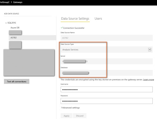

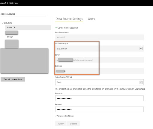

    RahilBukhari
    You need to add these two data sources to the same gateway, one for Azure SQL and one for on-premises AS as below.
    Herbert

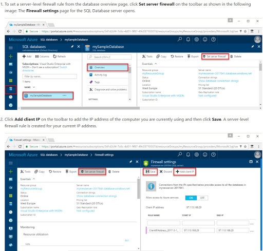

        RahilBukhari
        In Azure portal, have you enabled 'Allow access to Azure services' and set server firewall to provide access to client IPs?
        Please refer to this document.
