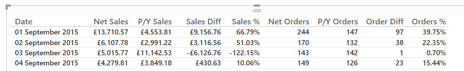

Thanks for that. The issue is that I want to display a total for these columns.
I have this table, the P/Y Sales and P/Y Orders a\re the problem columns here, both based on the current date -1 Year.
Maybe I can calacultae this in another fashion?

@konstantinos
After a bit of trial and error, the SUMX wrap has done the job, so many thanks for your help. Greatly appreciated.
