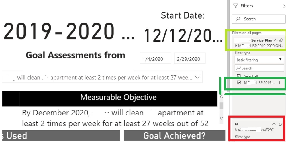

As an update on our successful progress 🎆 , here's a screenshot.
Since we're not using embedded scenarios, the red box shows the Filter for Record ID that was passed by URL but was not able to be passed to a PDF.
So, we added an additional "Filter on all Pages" for the "Service Plan Name" field.
Since it's unique for records of this Service Plan record type, PBI Svc displays a single record to select.
When selected, this results in the same tables as the Filter by the Record ID passed by the URL.
An extra step but relatively easy since it's just clicking a single filter box.
The next challenge is that another Service Plan record type is not unique, so we may need to create a unique key that will allow us to access fields in all of the dataset's tables that are required for this multi-page report...  Sounds like I may be posting another question 😊
Thanks to @v-yingjl and @GilbertQ for their coaching!
