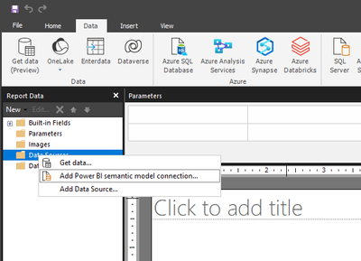

    You can start by publishing a report with a lot of transformations in Power Query to the Power BI service.
    Then open Power BI Report Builder. Sign in to your Power BI account. In the report data pane, select New > Power BI semantic model connection. Search for and select the Power BI dataset you want to use.
    Use Report Builder to design your reports. You can add elements such as tables, matrices, charts, etc., as needed.
    Once you've designed your report, you can export it directly from Report Builder to a Lux, Exel, or Pudfu format.
    Or publish to a Power BI report server.
