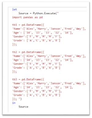

Instead of using the “Python Script” connector to import data, I need to use Python.Execute() function in power query to retrieve multiple query tables. Please refer to the steps:
1. In power query editor, create a blank query.
2. Create Python.Execute() function to run Python script in the bracket.
3. I create 3 tables with duplicate values just to demonstrate on how to filtered tables.
4. Python.Execute() allows you to create an aggregated query include multiple tables. With this query, we should be able to create a parameter to filter the table we want to display in the Desktop visual interface.
