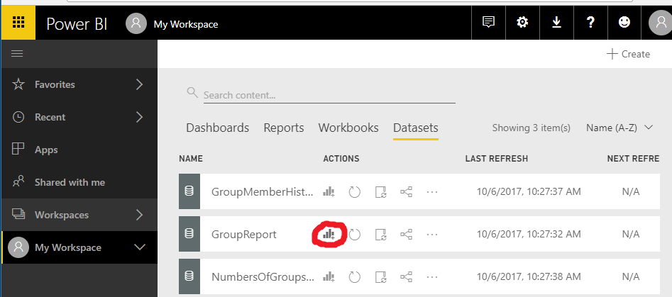

  1. Go to https://powerbi.microsoft.com and sign in.
  2. Go to the My Workspace drop down list, select Datasets and under the Actions heading click the graph icon to Create Report.

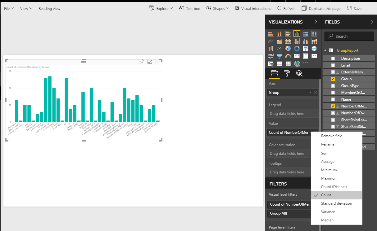

  3. Select the Stacked Column Chart under Visualizations.
  4. While the chart is still selected, check Group and NumberOfMembers under Fields.

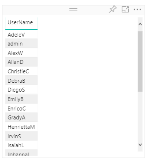

  6. Deselect the chart, and expand UserName under Fields. Now you get a table with all users that are members of any of your Office 365 Groups.

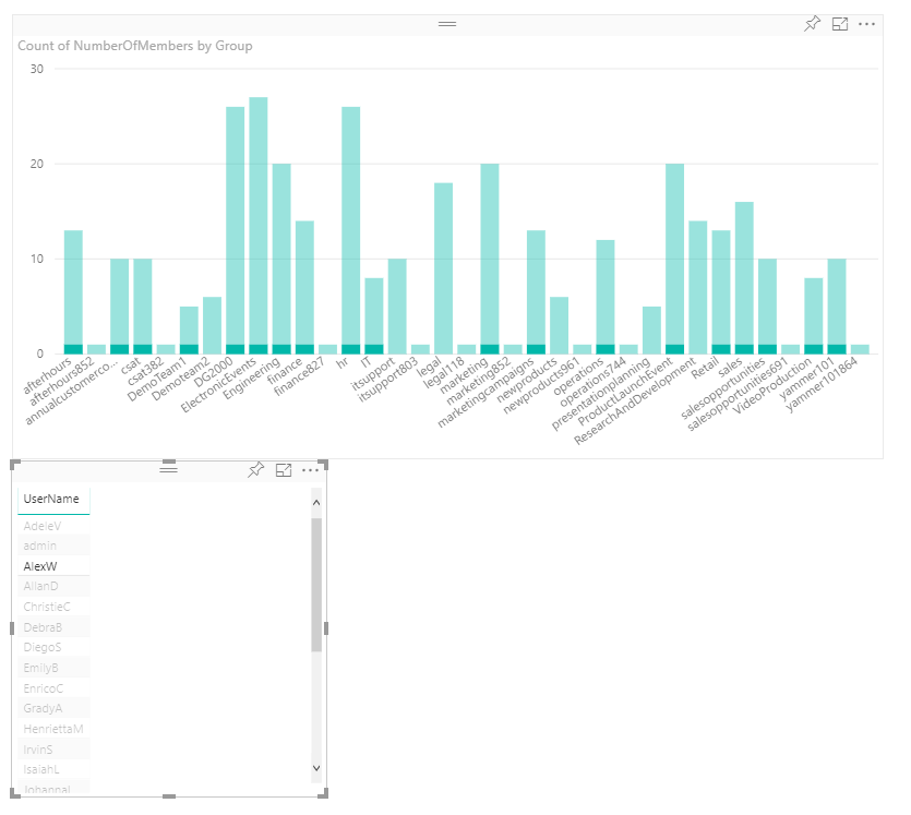

  7. Select a name in the UserName table and you see the magic of Power BI. You can now see in the "Stacked column chart" what groups the selected user is a member of.
  8. When you have run the update part of the script, just press refresh in the upper right corner to get the new data. This is a simple way to get data from any PowerShell source and create a report with that data in Power BI.
