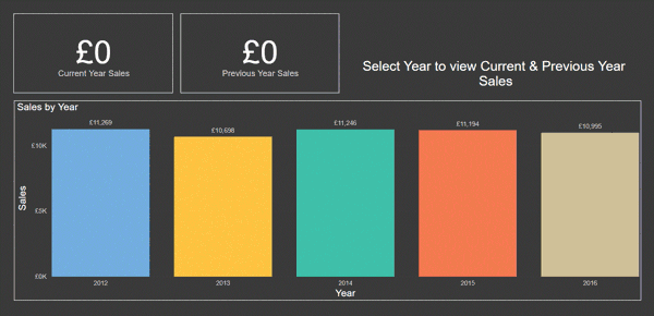

Let us consider the following bar chart visual, which visualizes the total sales over years.

Now, let us see how this is working, when we select a year bar on the bar-chart.
In the above short video, when I select 2013, the Current Year Sales display the 2013 year’s total sales value & Previous Year Sales display the 2012 year’s total sales value.
Just to add a little bit to the user experience I added the following card: (Select Year to View Current & Previous Year Sales)
A simple measure was added to get this:
Let us see the complete functionality in a single frame:
This is how we can get current year sales and previous year sales based on a selection from the visual. This approach can be implemented using other charts as well like Pie chart, Line chart, Table visual, etc.
