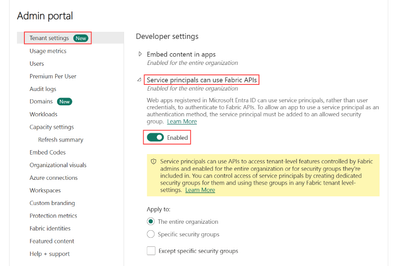

For your scenario  where you need to authenticate from an external C# application hosted in App Service  the best path today is to use:
  • User
  • Service principal
For more information on them check out: Identity support for logging into the Microsoft Fabric - Microsoft Fabric REST APIs | Microsoft Lear...
just ensure that you have enabled this service principal option in admin portal
If you find this post helpful, please mark it as an "Accept as Solution" and consider giving a KUDOS. Feel free to reach out if you need further assistance.
