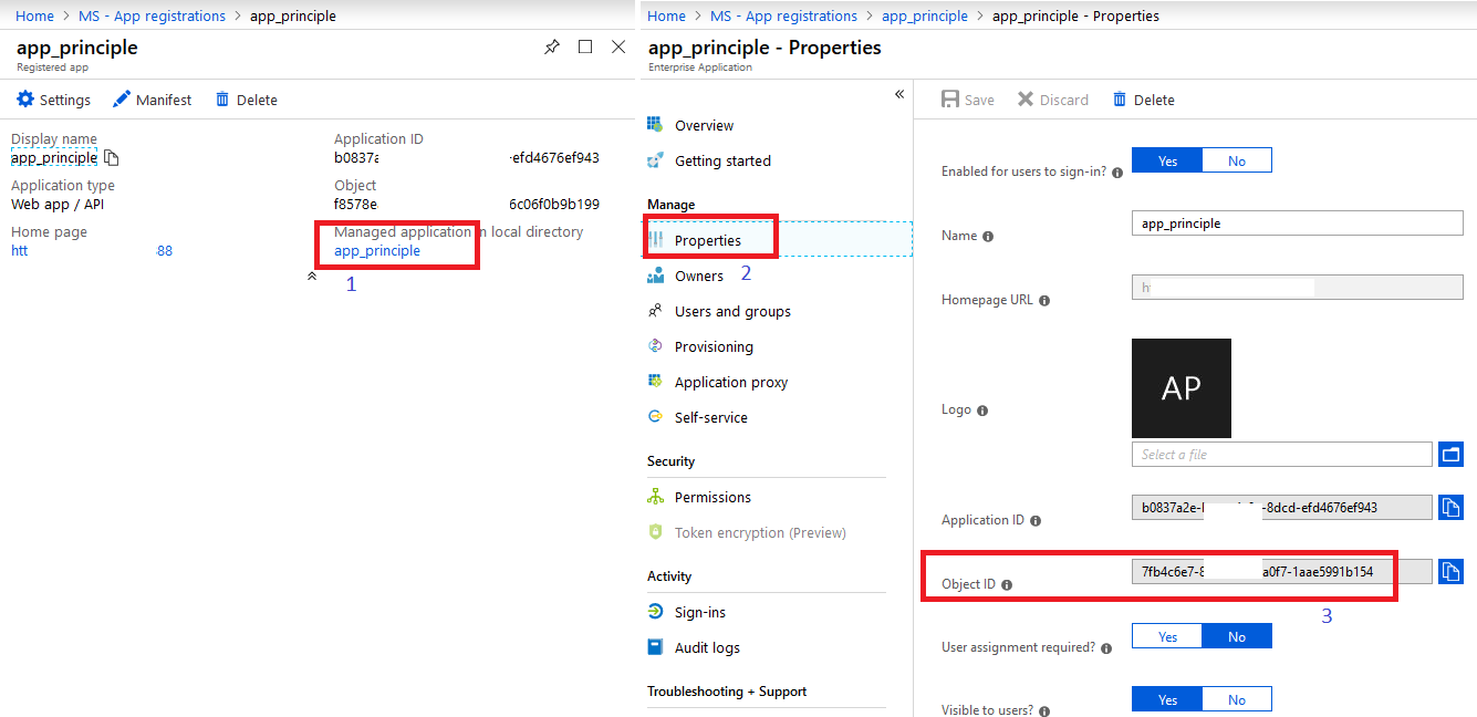

1. Add the Service Principal as an admin in the workspace directly rather than add the security group. Please refer to article 5 in embed-service-principal#get-started-with-a-service-principal. We should use the Object ID.

Thank you! Your first comment gave me an idea. My issue was that i did not add the Service Principal itself as Admin, i added the Security Group it belonged to. I was not able to choose a service pricipal in the UI when adding access permissions. Instead, i had to use the API and now everything is working fine.
