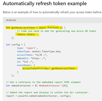

The following example from documentation is what I used as a template for writing my function:
Do you know if "return token" is a string or a type? If a type, is there documentation on what that type should be?
HI @etsygankov,
The token should be a variable defined with string type in the function and used to get the token string from API response.
