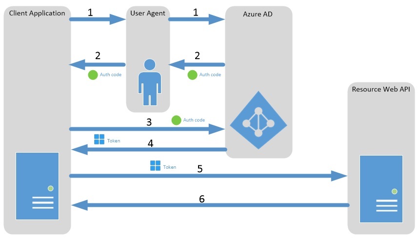

Authorization Code Flow diagram
I found this diagram with the corresponding explanation here which I am not sure whether my understanding of the flow is correct. Here is my understanding about the diagram above and would be appreciated if someone could correct me if I am wrong.
  1. The client application redirects the User Agent (The "master account" with Power BI Pro License and with Azure Global Admin Role in third-party embedding scenario) to the Azure AD authorization endpoint and lets the User Agent authenticates via Azure username and password.
  2. The Azure AD authorization endpoint redirects the user agent back to the client application with an authorization code.
  3. The client application requests an access token from the Azure AD token issuance endpoint by providing the authorization code.
  4. The Azure AD token issuance endpoint returns an access token and a refresh token.
  5. The client application uses the access token to authenticate and call to the Web API INCLUDING obtain an embed token for third-party embedding.
  6. After authenticating the client application, the web API returns the requested data.
Along the process, three different type of tokens were received. Each of their purposes is stated below:
  • Authorization code: Used for verification with Azure AD token issuance endpoint to obtain an access token
  • Access token: Used to call Power BI Web API
  • Refresh token: Used to request additional access tokens
  • Embed token: Used along with embed URL and embed report ID for embedding in custom web application. (Embed Token, Embed report ID and Embed URL are the 3 items required to do 3rd party embedding)
Thanks in advance for the help.

TedPattison
The Authorization Code Grant Flow is used to authenticate the current user but never the master user account. Therefore, the Authorization Code Grant Flow is used for first-party embedding with the user-owns-data model and never with third-party embedding and the app-owns-data model.
If yiu are using third-party embedding, you should use the User Credential Flow which is not an interactive flow. Here is a simple example.

Another key point is that you must grant permissions (i.e consent) to the Azure AD application for the master user account before you run this flow because this flow will fail if Azure AD attempts to prompt the user to consent to the application's required permissions.
I assume you are using third-party embedding and the app-owns data model and not first-party embedding with the user-owns-data model. Is this correct?
