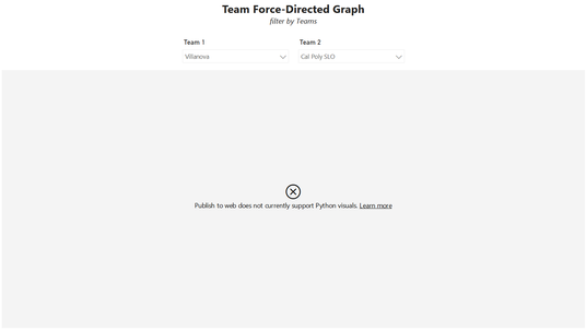

Hi everyone -
I ran into this error earlier today trying to publsih a python visual to web.  Does anyone know what's going on here?  I saw this article in a recent release and thought this should have been taken care of by now?  If not, is there a wordaround for this?
https://powerbi.microsoft.com/en-us/blog/python-visualizations-in-power-bi-service/
Thanks in advance for your help!

Hi @jmarcrum ,
The articlce you have referred is related with publishing from power bi desktop to power bi service that support Python visuals intead of publishing to web from power bi service. Please refer the difference between them:
  1. Publish from power bi desktop
  2. Publish to web
As your posted picture shows, the Python visual and the R script viusal are not supported in publishing to web currently. Perhaps you can submit the requirement to ideas to help us improve power bi and add your comments there to make this feature coming sooner: https://ideas.powerbi.com/forums/265200-power-bi-ideas

@jmarcrum - Another crazy thought, can you just put the Python code for shortest path into a Query Step? Then you wouldn't need to use a Python visualization.
