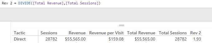

Here is what I have found. I was able to get the right numbers using this formula:
[Final Measure] = Divide([Measure1],[Measure2])
where [Measure1] = sum(value) and [Measure2] = sum(value)
Also, I had to create new measures, not edit existing measures. It would keep giving me the same wrong answers unless I created new measures with the correct formula. Maybe there is something with the way the data is cached.

Ok, check this out:
Total Revenue = sum([revenue)
Total Sessions = sum([sessions])
Revenue per Visit == Rev 2 but the answers are different. Rev 2 is correct. NO idea why.
