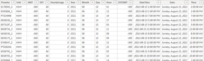

      Here is a sample data

    Data Sample
