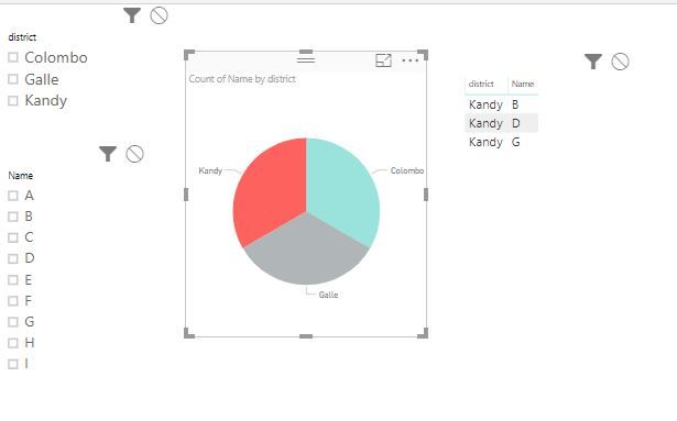

Hi Everyone,
I have a chart showing sum figures distric wise wherease have one drop down filter showoing same distric names, i want that fitler should be filtered for distric name selected in chart ,how can i achive the same ?
Ex: if i select calafornia in chart ,filter should show only calafornia no other distric ?

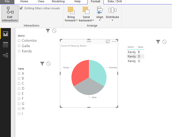

  • Hi msofficesolutio
    You should be able to do that.
    Click on your visual

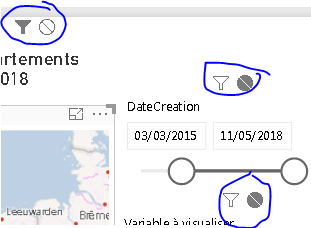

    On the tab above the report editor you have :
    Tools for visuals > Format
    Click on Edit interactions.
    Then choose wich other visual you want to filter, in that case your dropdown list, by clicking on the filter icon.
    - Quentin

      Hi Quentin,
      Thanks for suggestion , i tried the same already but it didn't worked, is that working at your end ?
      Manish

        msofficesolutio
        Yes it is working at my end, I'm able to filter them.
        Did you change your relation to bi-directionnal filter in PowerBI ? Maybe it's only filtering from A to B and not from B to A if you have differents table.
