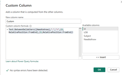

maybe you can try this in PQ
= Table.AddColumn(#"Promoted Headers", "Custom", each Text.BetweenDelimiters([NeedtoKnow],".",">",{0,RelativePosition.FromEnd},{0,RelativePosition.FromEnd}))

ll's response has worked well in my example, and here are the output results:
You may want to take note of the following:
If you are using a custom column approach and directly add the code provided by ryan_mayu into your custom column, the results in the advanced editor will appear as follows, which may lead to inconsistent output.
I recommend modifying it to the following:
If you wish to retain certain content, I suggest clicking the button in the image below and making adjustments in the advanced editing page:
