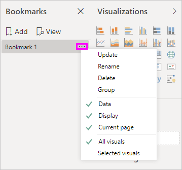

Uncheck the data
Select sub-menu for a bookmark by using the ellipses
