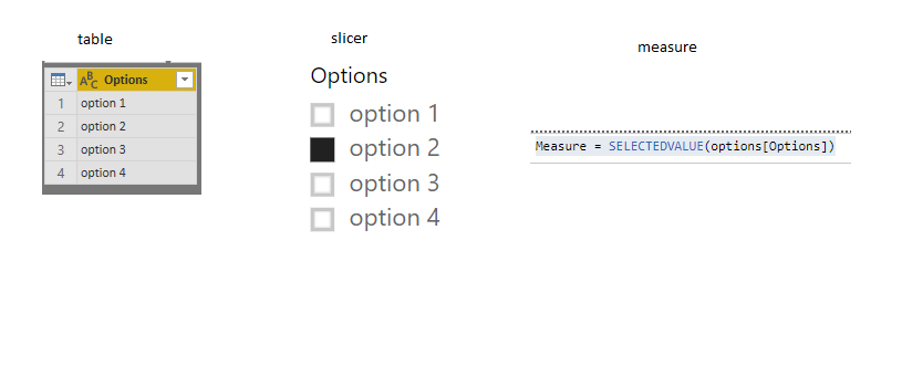

1. defining a table 'Options', which contain the different possibilities.
Adding a slicer on top of it, and setting a measure which is defined by SELECTEDVALUE
however, I didn't find a way to access the measure value from the advanced query editor.

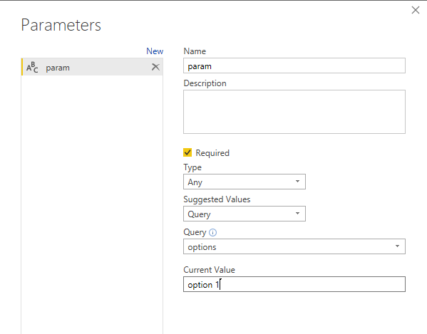

2. defining a parameter, and using the syntax "&Text.From(<parameter_name>)&" inside the advanced query editor.
However, I coudln't bind the parameter to the chosen value from the slicer.
iilustartion 2

Hi @drcohen,
From your information, it seems that you want to have access to the measure value from the query parameter. I'm afraid that we may not achieve the Selectvalue in the measure in Current value field currently.
What do you want to do? We may try another way to achieve your requirement.

Hi @drcohen,
From your information, it seems that you get data with the connector of Azure Data Explorer(Beta).
Based on this limit, Kusto's default limits (500,000 rows or 64MB, as described in the Query Limits section).
You could refer to here, I think that we could use set the parameter in your query steps, but I don't know if your query support the option like IN function in T-SQL, if not, you may use query like this:
Table.SelectRows(#"Added Custom", each [Custom] = P1&"d")
