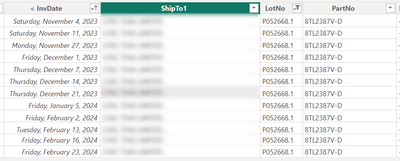

date gap between multiple item for occurrence in different month
hi all
whats the formula to calculate the days gap between each of the entry?
line1: nov 4  to nov 11
line2: nov11  to nov 27
line3:  nov27 to Dec 1
