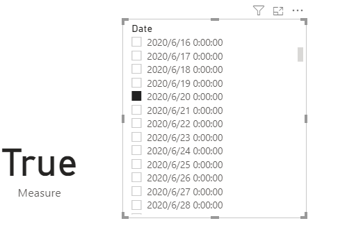

create measure comparing dates from different tables
HI
i have a table with column "date from" and  column "date to"
and anothe table with all dates isung it as a filter
i want to creat a measure which will give me "true" or "false" if the date in the filter is in the range of the "datefrom" -"dateto"
examp - date from = 1/1/2020 date to 9/1/2020 , if i click the filter 10/1/2020 i'll get "false" and if the filter say 2/1/2020 it will be "treu"
thank you!!
@oren
You can create the following measure by checking the attached pbix if necessary.
Medida: IF(SELECTEDVALUE('Table 2'[Date]) en VALUES('Table'[Date]),TRUE(),FALSE())

@oren

@oren , Try measure like
measure =
if(isblank(max(Date[Date])),0,1)
or
measure =
var _min =minx(allselected(date),date[date])
var _max =maxx(allselected(date),date[date])
return
if(isblank(calculate(countrow(Table), filter(Table, Table[Date] <=_max && Table[Date] >=_min))),0,1)
