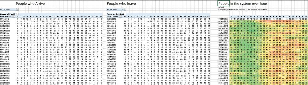

This shows a typical row layout in the [EDTable]
This shows how I used to do it in excel with the required output date/hour table, however I need to do this within PBI
The required output would be an active measure of patients in the department in that hour of the day that I could use in heatmap table or on graphs and be dynapically slicable based on fields in the master [EDTable]

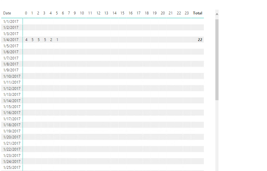

Once again thank you very much Victor,
I've tried it and have some very odd answers, I understand it and it should work.
I am in the process of de-bugging it and am trying it piece by piece comparing the measure outputs of the admission and discharge numbers with the ACTUAL numbers which are easy to get form tables of (Admission date/Admission Hour+Patient ID) and (Discharge date/Discharge Hour+Patient ID). The trick is to subtract one from the other on an ongoing basis.
At the moment they show different numbers and I need to find our why, however it does change based on the slicers.
I will keep trying on this and keep posting as I hope others will benefit once it's cracked.
Thanks, and any other options welcome!
Paul
Enclosed are some problem solving tables. The top right is the measure as provided and looks good but the numbers are wrong, the next two tables are the individual arrival and discharge tables as provided by the measure, they are alo incorrect. The two tables below are the actual counts of arrivals and discharges by counting the rows by dropping them into the table. I can't figure out why they are different. I've lookes through each hour of the day and manually counted the rows and the bottom tables are correct (Date in the row, hour in the column, count of Patient ID in the value). One for admission times, one for discharge time, What I can't figure out is why the measure isn't working, anyhelp would be appreciated. The numbers it creates don't make any sense relative to the actuals.
