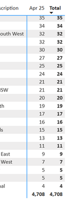

I have a simple stacked bar chart like the below, each color is like one State, and the measure is like "sum of units", very simple,
i.e. like the below in March, the 7 States adds up to totally 4519 units, which is the correct number.
 i also have a 2nd layer of the geogrphy, which is "City", each State above are consisted by a bunch of Cities. When i put "City" into the legend instead of the "State", the total is less (consistantly each month), see below, March is only 4,283 units.
the part that i can't diagnose is that i filtered for each State in the city view chart, for example, below is the city breakdown for bottom State (see the State view chart), dark green color, showing 607 units, and the breakdown below adds up to 607 correctly. i checked all State individually, it's all correct.
i also check the "show as table" for the total city view, each number of March adding together still equals 4719, but why the bar total shows 4283....anyone knows why?

Without knowing much about how your data is set up, it is difficult to say if this is a DAX formula issue or a data issue. I would need to know a little bit more about how the data is set up. One thing to consider is to check whether your Location Dim table (the table where you have your state/city) information is set up correctly. i.e. Do all the cities have state values, and vice versa.
One way to continue diagnosing is to create a matrix, where your rows are State, City, and from there see if you are able to determine which cities (or blanks!) are not returning any results.
Hi ExcelMonke
thanks for your suggestion on using a matrix table, here's some updated information:
when not expanded, just showing at the State (provincia) level, the table and bar chart is aligned
simply expand the matrix table, the total is still correct in the table, but when replacing the legend to city in the bar chart, the total reduces
there's no DAX formula for the measure, it's just a simply auto sum of a column called "Units"
I have also double check the relationship structure between State and City, it's all unique otherwise the matrix table won't be correct anyway? it's really weird...

@v-hjannapu thank you, but this doesn't seem to be the answer to the issue, firstly, in this case, even in the matrix, all cities has a value, therefore it should be the same for the bar chart. plus even if there are zero value cities, it may display more rows in the matrix than in the bar chart, but the SUM total should still be the same

Hi
thanks but as i described that all cities do have values, and the total does not match.
please see the sample pbix file here
https://drive.google.com/file/d/1RJWD3k7g0xH886iREEC1cywWCnnWzlzV/view?usp=sharing
