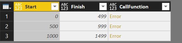

This is what I''m trying now:
let Function = (Start as text, Finish as text) => let Source = Json.Document(Web.Contents("https://api.insight.ly/v2.2/Organisations?skip="&Start&"&top="&Finish&"&", [Headers=[Authorization="Basic *****", ContentType="application/json"]])), data = Source[data], #"Converted to Table" = Table.FromList(data, Splitter.SplitByNothing(), null, null, ExtraValues.Error), #"Expanded Column1" = Table.ExpandRecordColumn(#"Converted to Table", "Column1", {"ORGANISATION_ID", "ORGANISATION_NAME", "BACKGROUND", "IMAGE_URL", "OWNER_USER_ID", "DATE_CREATED_UTC", "DATE_UPDATED_UTC", "VISIBLE_TO", "VISIBLE_TEAM_ID", "VISIBLE_USER_IDS", "CUSTOMFIELDS", "ADDRESSES", "CONTACTINFOS", "DATES", "TAGS", "LINKS", "ORGANISATIONLINKS", "CAN_EDIT", "CAN_DELETE", "SOCIAL_LINKEDIN", "SOCIAL_FACEBOOK", "SOCIAL_TWITTER"}, {"ORGANISATION_ID", "ORGANISATION_NAME", "BACKGROUND", "IMAGE_URL", "OWNER_USER_ID", "DATE_CREATED_UTC", "DATE_UPDATED_UTC", "VISIBLE_TO", "VISIBLE_TEAM_ID", "VISIBLE_USER_IDS", "CUSTOMFIELDS", "ADDRESSES", "CONTACTINFOS", "DATES", "TAGS", "LINKS", "ORGANISATIONLINKS", "CAN_EDIT", "CAN_DELETE", "SOCIAL_LINKEDIN", "SOCIAL_FACEBOOK", "SOCIAL_TWITTER"}) in #"Expanded Column1", //Table2 Source = #table({"Start", "Finish"}, {{0, 499},{500, 999},{1000, 1499}}), //CallFunction CallFunction = Table.AddColumn(Source, "CallFunction", each Function(Text.From([Start]),Text.From([Finish]))), //Function #"Expanded CallFunction" = Table.ExpandTableColumn(CallFunction, "CallFunction", {#"Converted to Table", "Column1", {"ORGANISATION_ID", "ORGANISATION_NAME", "BACKGROUND", "IMAGE_URL", "OWNER_USER_ID", "DATE_CREATED_UTC", "DATE_UPDATED_UTC", "VISIBLE_TO", "VISIBLE_TEAM_ID", "VISIBLE_USER_IDS", "CUSTOMFIELDS", "ADDRESSES", "CONTACTINFOS", "DATES", "TAGS", "LINKS", "ORGANISATIONLINKS", "CAN_EDIT", "CAN_DELETE", "SOCIAL_LINKEDIN", "SOCIAL_FACEBOOK", "SOCIAL_TWITTER"}, {"ORGANISATION_ID", "ORGANISATION_NAME", "BACKGROUND", "IMAGE_URL", "OWNER_USER_ID", "DATE_CREATED_UTC", "DATE_UPDATED_UTC", "VISIBLE_TO", "VISIBLE_TEAM_ID", "VISIBLE_USER_IDS", "CUSTOMFIELDS", "ADDRESSES", "CONTACTINFOS", "DATES", "TAGS", "LINKS", "ORGANISATIONLINKS", "CAN_EDIT", "CAN_DELETE", "SOCIAL_LINKEDIN", "SOCIAL_FACEBOOK", "SOCIAL_TWITTER"}}, {#"Converted to Table", "Column1", {"ORGANISATION_ID", "ORGANISATION_NAME", "BACKGROUND", "IMAGE_URL", "OWNER_USER_ID", "DATE_CREATED_UTC", "DATE_UPDATED_UTC", "VISIBLE_TO", "VISIBLE_TEAM_ID", "VISIBLE_USER_IDS", "CUSTOMFIELDS", "ADDRESSES", "CONTACTINFOS", "DATES", "TAGS", "LINKS", "ORGANISATIONLINKS", "CAN_EDIT", "CAN_DELETE", "SOCIAL_LINKEDIN", "SOCIAL_FACEBOOK", "SOCIAL_TWITTER"}, {"ORGANISATION_ID", "ORGANISATION_NAME", "BACKGROUND", "IMAGE_URL", "OWNER_USER_ID", "DATE_CREATED_UTC", "DATE_UPDATED_UTC", "VISIBLE_TO", "VISIBLE_TEAM_ID", "VISIBLE_USER_IDS", "CUSTOMFIELDS", "ADDRESSES", "CONTACTINFOS", "DATES", "TAGS", "LINKS", "ORGANISATIONLINKS", "CAN_EDIT", "CAN_DELETE", "SOCIAL_LINKEDIN", "SOCIAL_FACEBOOK", "SOCIAL_TWITTER"}}) in #"Expanded CallFunction"
Which retunrs the error: "Expression.Error: Name "Converted to Table" not found. Make sure it is spelled correctly.
After removing the last step of the query (Expanded CallFunction), I see the table:
What am I doing wrong?
The error-message you've posted relates to the last step "Expanded CallFunction" which must fail, also because the column is not expandable yet (no expand arrows in the picture) and the nested curly brackets would also not work to my knowledge. So that step has probably to be rebuilt after the underlying error has been solved:
The error that causes the error-messages in each field of the column itself.
To retrieve it, please don't click on the word "Error" itself, but right next to it in the white space. Then down below the error-message should be shown.

The error seems to be here:
Source = Json.Document(Web.Contents("https://api.insight.ly/v2.2/Organisations?skip="&Start&"&top="&Finish"& , [Headers=[Authorization="Basic ****", ContentType="application/json"]])),
I want to express this:
Source = Json.Document(Web.Contents("https://api.insight.ly/v2.2/Contacts?skip=0&top=499", [Headers=[Authorization="Basic ***", ContentType="application/json"]])),
No matter how I play with the ", I always get the syntax error:
Comma token expected
Ah, syntax-checking in functions really is a pain. But I think I got it:
Source = Json.Document(Web.Contents("https://api.insight.ly/v2.2/Organisations?skip="&Start&"&top="&Finish&" , [Headers=[Authorization="Basic ****", ContentType="application/json"]])),
Switched &" after "Finish"

I still get the same error in the word Basic
Please always post the original error-messages.
But if it "moved" to the Authorization-part already, this has nothing to do with the function-parameters we're passing to it. So please compare carefully with the original code you've posted which returned the correct results.
You can also check/debug the function like this:
//Function = (Start as text, Finish as text) => let
Start = "0",
Finish = "499", Source = Json.Document(Web.Contents("https://api.insight.ly/v2.2/Organisations?skip="&Start&"&top="&Finish&"&", [Headers=[Authorization="Basic *****", ContentType="application/json"]])), data = Source[data], #"Converted to Table" = Table.FromList(data, Splitter.SplitByNothing(), null, null, ExtraValues.Error), #"Expanded Column1" = Table.ExpandRecordColumn(#"Converted to Table", "Column1", {"ORGANISATION_ID", "ORGANISATION_NAME", "BACKGROUND", "IMAGE_URL", "OWNER_USER_ID", "DATE_CREATED_UTC", "DATE_UPDATED_UTC", "VISIBLE_TO", "VISIBLE_TEAM_ID", "VISIBLE_USER_IDS", "CUSTOMFIELDS", "ADDRESSES", "CONTACTINFOS", "DATES", "TAGS", "LINKS", "ORGANISATIONLINKS", "CAN_EDIT", "CAN_DELETE", "SOCIAL_LINKEDIN", "SOCIAL_FACEBOOK", "SOCIAL_TWITTER"}, {"ORGANISATION_ID", "ORGANISATION_NAME", "BACKGROUND", "IMAGE_URL", "OWNER_USER_ID", "DATE_CREATED_UTC", "DATE_UPDATED_UTC", "VISIBLE_TO", "VISIBLE_TEAM_ID", "VISIBLE_USER_IDS", "CUSTOMFIELDS", "ADDRESSES", "CONTACTINFOS", "DATES", "TAGS", "LINKS", "ORGANISATIONLINKS", "CAN_EDIT", "CAN_DELETE", "SOCIAL_LINKEDIN", "SOCIAL_FACEBOOK", "SOCIAL_TWITTER"}) in #"Expanded Column1",
This enables you to localize the step in which the error actually occurs.
