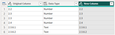

Try this Power Query solution. The concept is to determine if the original value is number or text; if number, round to the appropriate number of decimal places, otherwise return the original value.
Source = Table.FromRows(
Json.Document(
Binary.Decompress(
Binary.FromText("i45WMtIzUorVAdHGaLQJjK9npmeIxAaqjwUA", BinaryEncoding.Base64),
Compression.Deflate
_t = ((type nullable text) meta [Serialized.Text = true])
type table [#"Original Column" = _t]
AddDataTypeColumn = Table.AddColumn(
Source,
"Data Type",
each
result = try Number.From([Original Column]) otherwise "Text",
resultType = if result = "Text" then "Text" else "Number"
resultType
AddNewColumn = Table.AddColumn(
AddDataTypeColumn,
"New Column",
each
if [Data Type] = "Number" then
Number.Round(Number.FromText([Original Column]), 1)
else
[Original Column]
ChangeType = Table.TransformColumnTypes(AddNewColumn, {{"New Column", type text}})
ChangeType
