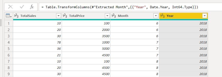

Transpose date from raw to column
Hi everyone,
I have the following issue:
On the first raw there is the year and on the second the month for the column TotalSales and TotalPrice (the first two columns are referred to TotalSales and TotalPrice for June 2018, the third and fourth for July 2018 etc..). Is there any way to transpose the date on the format "mm-yyyy" next to the single columns TotalSales and TotalPrice?

  • Anonymous what should the end result look like?

    I was able to get to this result :
    using this as my dataset:
    by doing the following:
    1.) Transposing the table.
    2. Highlighted the date and year columns then doing fill down.
    3. Highlighting the three value columns then doing unpivot columns.
    4. Highlighting the TotalSales/TotalPrice column then pivoting the column using the new value column.
    5. Removed the unnecessary column.
    6. Renamed the columns to have Year and Date as Column names.
    Here's what the M code looks like:

    Anonymous wrote:
    Hi Watsky,
    it should be like this:
    With the date on two columns (year and month) that are on the two first raws right now.
    Thanks in advance for the support

      Hi Watsky,

        Anonymous wrote:
        Hi Watsky,
    Thanks Watsky for the solution!
