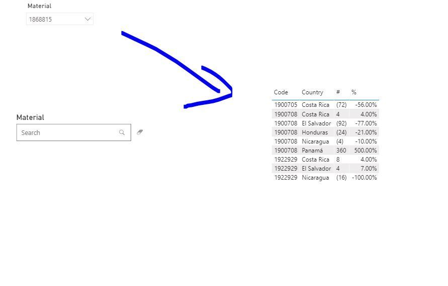

I added a text filter in order to easily recreate a table.
The problem is that when you enter a value, the table will not be updated. But when you use a drop-down cutter, you will.
For example, I use: 1868815 in my slicer and will correctly display the values:

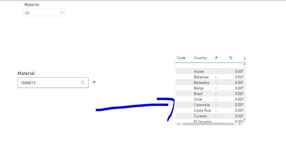

And the text filter will show all values in the table:
How do I get the text filter frequently?

There's more than one issue here.  Text filter filters text not numbers (it will filter them if both fields are set as text).
The tables material1 and material2 have duplicate entries (filtering from many-to-one might work but does it make sense) -> I edited that and went off and tested many to one filtering , it can work but it doesn't really make sense)

Relationships and directions.
The text filter on Material2 can't filter anything because of the relationship direction.
Hi @HotChilli
Changed it to text and it worked.
Thanks!
