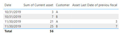

  • You can have a measure as below:
    Asset Last Date of previou fiscal =
    var _selD = SELECTEDVALUE(SumAssets_AssetTable[Date])
    var _val = CALCULATE( Max(SumAssets_CalendarTable[Last Date of Previous Fiscal]), FILTER(SumAssets_CalendarTable, SumAssets_CalendarTable[Date] = _selD))
    var _asset = CALCULATE(sum(SumAssets_AssetTable[Current asset]), SumAssets_AssetTable[Date] = _val)
    RETURN if ( HASONEVALUE(SumAssets_AssetTable[Date]), _asset)
    Say, you have the relationship as below:
    Data as
    Output will be as
    To display exactly your needs, you can filter the visual as
    Hope this helps!
