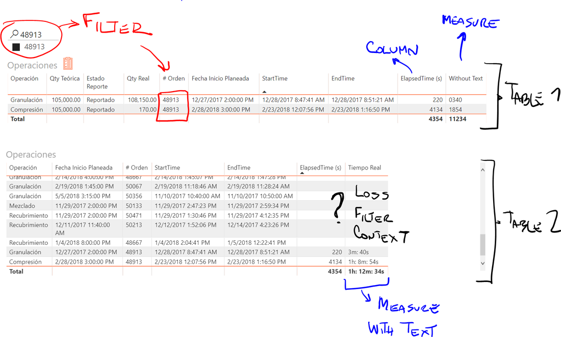

I'm working with time intervals in PowerBi. This topic was very useful for me but I need a little more help from you.
I have a table in the model (Orders) with #Order, StartTime, EndTime and ElapsedTime in seconds and I need to visualize the total elapsed time in format hhh:mm:ss (Elapsed Time is usually greather than 24 hours)
I did two measures to see the problem:
The first (Without Text) realize the calculations to express elapsed time in the new format, but I've trimmed the text formatting for testing purposes.
Without Text = VAR Duration = SUMX('Reportes de Operaciones';'Reportes de Operaciones'[ElapsedTime (s)]) VAR Hours = INT(Duration/3600) VAR Minutes = INT(MOD(Duration;3600)/60) VAR Seconds = MOD(Duration;60) RETURN CONCATENATE (Hours; CONCATENATE (Minutes;Seconds ))
The Second (Real Time), do the same calculations, but I've added format to display elapsed time in hhh:mm:ss
Tiempo Real = VAR Duration = SUMX('Reportes de Operaciones';'Reportes de Operaciones'[ElapsedTime (s)]) VAR Hours = INT(Duration/3600) VAR Minutes = INT(MOD(Duration;3600)/60) VAR Seconds = MOD(Duration;60) VAR H = IF ( LEN ( Hours ) = 1; CONCATENATE ( "0"; Hours ); CONCATENATE ( ""; Hours ) ) // Minutes with leading zeros VAR M = IF ( LEN ( Minutes ) = 1; CONCATENATE ( "0"; Minutes ); CONCATENATE ( ""; Minutes ) ) // Seconds with leading zeros VAR S = IF ( LEN ( Seconds ) = 1; CONCATENATE ( "0"; Seconds ); CONCATENATE ( ""; Seconds ) ) VAR tH = IF(Hours=0;"";IF(Hours>1;Hours&"h: ";Hours&"h: ")) VAR tM = IF(Minutes=0;"";IF(Minutes>1;Minutes&"m: ";Minutes&"m: ")) VAR tS = IF(Seconds=0;"";IF(Seconds>1;Seconds&"s";Seconds&"s")) RETURN CONCATENATE (th; CONCATENATE ("";CONCATENATE (tm;CONCATENATE (""; CONCATENATE (ts;"" )) )))
Now..
In Table 1 you see that "Without text" measure works perectly but show unformatted data (obviously).
In Table 2 you see that "Tiempo Real" measure shows formatted data but.... I've lost de filter context.
How do I to fix this? My brain burns...
