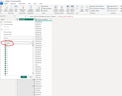

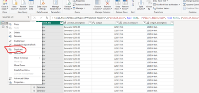

1. From PQ duplicate table :
2. Remove all the columns except 2 needed :
3. Remove duplicates from output description:

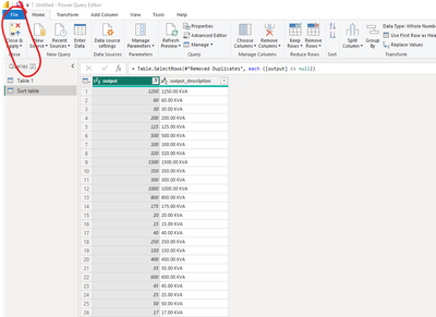

4. Filter out "null" (if you have)
5. Close and apply
6. create a relationship between the sort table and the main table
7. In the sorting table apply a wanted sorting logic :
8. Use the sorting table as a slicer, it will filter the main table due to their relationship :
The pbix is attached

And it's solvable. Here are the steps you need to take:
5. Close and apply
If this post helps, then please consider Accepting it as the solution to help the other members find it more quickly
