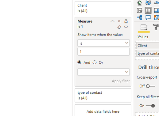

Then create a measure for visual level filter:
Measure = IF(SUM(slicer[value])=SUM('Table'[value]),1,0)

Hi there,
First of all, thank you so much for this amazing solution! I've learned alot from what you've done, thank you!
I tried applying this solution to my report, but unfortunately it doesn't work, here's a recording of the output 2.gif
Notice: NIF's refers to the Client identifier (NIF = Fiscal Number). Each client has a unique identifier/NIF, which can be duplicated in the raw data.
What can I provide you with, to best help figure out a solution for this?
