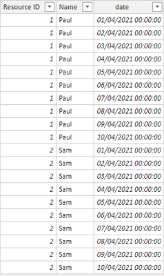

This is an optimized and newly written method
1. Create a calculated table,
Table =
GENERATEALL(
    'Resource Table','Date Table')
result:
2. Create a calculated table.
Table 2 =
GENERATEALL(
    'Table',
    var _tableid='Table'[Resource ID]
    var _tabledate='Table'[date]
    return
    SELECTCOLUMNS(
        CALCULATETABLE('BookingsTable','BookingsTable'[Resource ID]=_tableid&&'BookingsTable'[Date]=_tabledate),
        "Hours Booked",'BookingsTable'[Hours Booked]))
3. Create a calculated column.
Book% = 'Table 2'[Hours Booked]/8
4. Use The Book% of Table2 as a cutter
5. Result.
You can download the PBIX file from here.
Best regards
Liu Yang

Don't @PBIUser007,
Table =
GENERATEALL(
result:
Table 2 =
GENERATEALL(
    'Table',
    return
    SELECTCOLUMNS(
5. Result.
Best regards
Liu Yang
