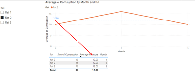

Hi @MartaCB ,
The measure that you add is that average when you select a specific flat. For the values I have the averages are:
Flat 1 - 1: 10 2: 15 3: 12 = 12.33
Flat 2 - 1: 10 2: 16 3: 10 = 12
Flat 3 - 1: 12 2:13 3: 10 = 11.67
In the chart has you can see the line reflect those averages per flat
Regards
Miguel Félix
