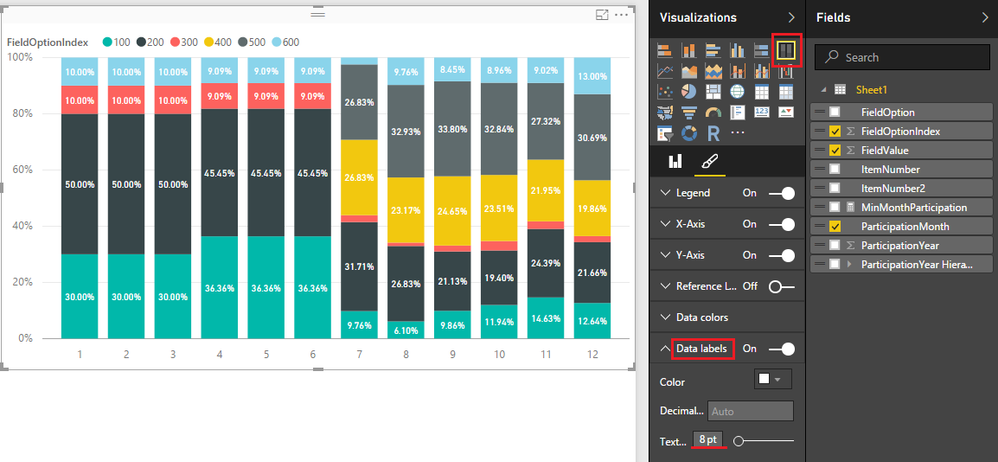

Now create a Stacked Column Chart - Hit the Stacked Column Chart Visualization button and
again drag the fiels as in the picture
Then click the Format paint brush - change X-Axis and add data labels
Now make sure you select the Stacked Column Chart we've just created
Hit Ctrl+C then Ctrl+V - move the copy so both chart are visible
Now all you do is select the copy and click the 100% Stacked Column Chart button
If some of the
Thanks for detailing the steps you took. It's all working well - I just need to get the legend sorted in the same order as the % stacked bars - at the moment it's sorted in the wrong order (see screenshot). Any ideas on how to fix this?

@ReubenPearse This is very strange it should be sorted that way! Don't know why?
I don't think you can sort the Legend (you can by adding numbers but don't know if its worth it)
This is what I get by default! Try turning it off/on - change the placing? Don't know...
