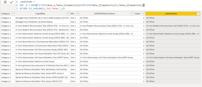

Hello! I have 2 unrelated tables where I need to pull some information across into the second table. Table 2 contains all "capabilities", but table one only has a few of those capabilities listed. Utilizing LOOKUPVALUE, I was able to match the available capabilities into table 2 from table 1. However, in Power BI, the cells that do not match naturally come back as blank. That being said, I am trying to figure out how to return the "alternate value" from Table 1 (in this case, it is called "All Other"). This alternate value needs to be the value listed in the first table and not just free text. To simplify, I need to have all non-matching values in table 2 return the unmatched value from table 1. If LOOKUPVALUE will not work here, I'm open to other suggestions! Here's a screenshot:
Thank you in advance!

Thank you for that but something is still off. It's clearly on my end because it worked well for you. One thing to note, however, is that the "other" option in the formula (i.e, if the value is not found in table 1), needs to return the other value from Table 1 and not be free text. For certain subsets of data, the unmatched values could be listed as "All", or "All Other", but it all depends on the data. That's why I can't use just free text in the "IF" statement argument. So anyway, here's what I'm seeing in my full dataset. That column with the green highlights is a simple LOOKUPVALUE formula. The green highlighted cells should say "All Other" because the values in those rows do not match anything from Table 1. As we can see here, the column with the blue highlights is indicating which cells should say "All Other". You can see that SOME are correct, but not all.
Again, I appreciate the efforts here.

Hello and thank you for the information! Unfortunately your solution is showing me data where it isn't expected. I exported the data table into Excel and hid some columns but it still shows what's going on. For some more context, I used "Lab Sciences Lead Time" as Table #1 and "SA Capabilities" as Table #2. So did I do something wrong here? The red cells should say "All Other"
Since the red cells do not match up to what's in Table 1, they should say "All Other" as opposed to the values present.
Thanks again!
