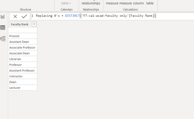

      When i posted before, someone told me to create a separate table and then use it in this measure. here's the table i created (called Replacing 0's) which I reference at the end of the measure you corrected for me :
      I'm not sure if this separate table is needed and if I can just use a measure referencing my main dataset (i.e. is there a way to not use the 'Replacing 0's table)?
