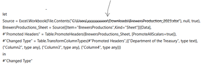

Cookistador
The easiest way to do that
It is by using advanced editor in Power query
You have to check what is the different in the applied steps
To do that, in Power query  in home, select advanced editor
You should see something like:
Source = Excel.Workbook(File.Contents("C:\Users\xxxxxxxxxxx\Downloads\BrewersProduction_2023.xlsx"), null, true),
BrewersProductions_Sheet = Source{[Item="BrewersProductions",Kind="Sheet"]}[Data],
#"Promoted Headers" = Table.PromoteHeaders(BrewersProductions_Sheet, [PromoteAllScalars=true]),
#"Changed Type" = Table.TransformColumnTypes(#"Promoted Headers",{{"Department of the Treasury", type text}, {"Column2", type any}, {"Column3", type any}, {"Column4", type any}})
#"Changed Type"
You can replaced the first step by the steps for your sharepoint folder,
You just have to be careful when you replaced something with the previous name
In the name of your step, the previous step must be mentionned
If you need some suppport, you can share the advanced editor code of one sharepoint file and one onedrivefiles (with the steps applied on it)
Kind regards
