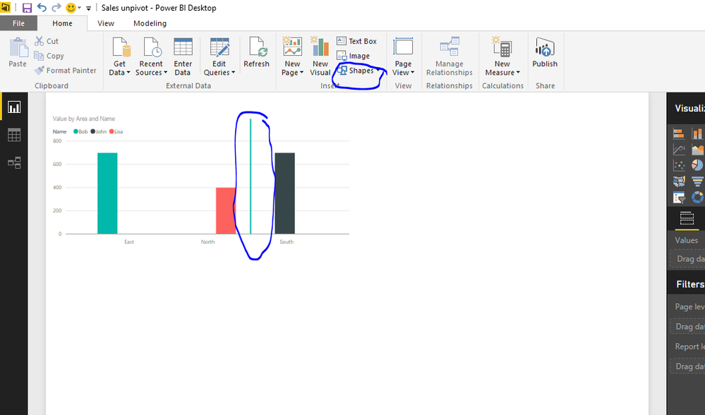

BhaveshPatel
Hi @naitiksoni
To draw the Vertical reference line is currently not possible. You can use bit of trick though. Use Shapes to create a static vertical line and it is not dynamic as explained. See the attached screenshot.
Thanks & Regards,
Bhavesh
Love the Self Service BI.
Please use the 'Mark as answer' link to mark a post that answers your question. If you find a reply helpful, please remember to give Kudos.

BhaveshPatel
Hi @naitiksoni
Thanks & Regards,
Bhavesh
