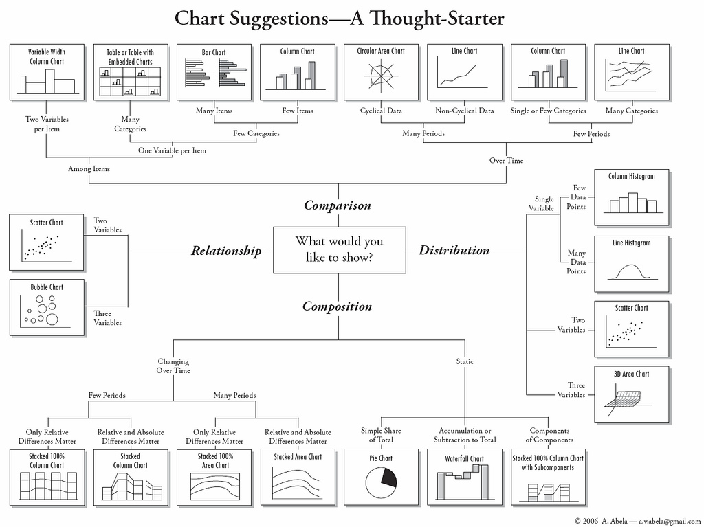

Also think about if the chart you select is the best choice for the information you need to show
This imagen can guide you to select the best graph considering some stuff
