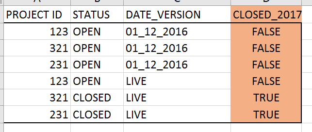

I would liketo create a customed column (the orange one) in my table, that tells me the evolution of the status of a project depending on the time version. For instance here, in my Project ID my projects appear as many times as there are different time version saved. But I would like to write a formula telling me in a new colum the evolution, if there is, of the status for each project between the LIVE version and the others. However I have no clue how I could do that and what the synthax is...

It helps but maybe I wasn't super clear in my initial request. It's a bit more complicated: I have multiple date version (not only december but all the months of many years), so I want to get a TRUE when for instance there is a variation of status for the same project between two versions (I choose a comparison betwwen December 2016 and today=LIVE).  Something like :
IF (Project_ID=123 & Version=LIVE & Status=CLOSED) AND (Project_ID=123 & Version=01_12_2016 & Status=OPEN) THEN TRUE
ELSE FALSE
But I don't really know how to manage these multiple AND...
