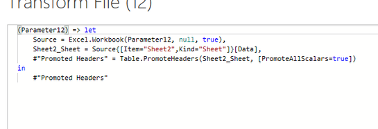

This is the custom function being invoked.

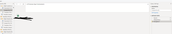

The parameter 12 it refers to points to this binary file.
from which it extracts the following table from a sharepoint and promotes headers as such.
This function works alone.
However when invoked in another table, it spits out that error.
