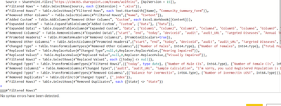

Here is the Power Query code please.

In  your code you access a SharePoint directory and filter by a file starting with the name "Community_..."
So my first questions is:
Do you have multiple of these files stored in the SharePoint directory? maybe on deeper level? When you run the script in Power Query do you see only one file as a result or multiple ones?

Doesn't seem to be anything odd in that part of the code.
Can you show the full code?
How many more steps are there?

I have about 19 steps.

This is a long shot and I don't expect it to work, but for the sake of troubleshooting, can you change where is says [ApiVersion = 15] to [ApiVersion = 14]?
Test refresh in Desktop and Service again.
Also, double check credentials for the dataset in the Service.

I edited the APIVersion as recommended; it still did not work. I have checked the crendentials and they are correct. I still do not have a headway on this problem.
