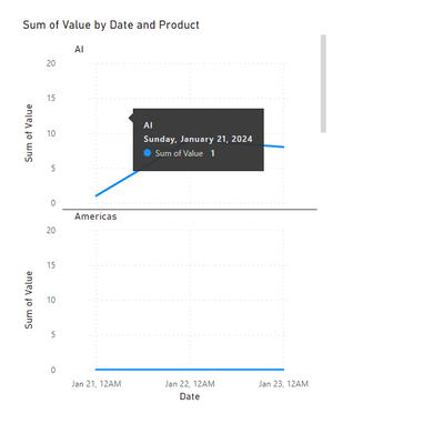

    Based on your consideration, you can try the folloing solution.
    Create a line chart, then put the date to x-axis, and put the value to the y-axis, then put the product to small multiples.
    Then in properities, set the column of small miltiples to 1.
    Output

        Hi Anonymous
        Thanks for your quick reply.
        Output
        Best Regards!
