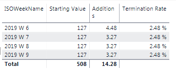

Basic Power BI table below:
 Bi Table

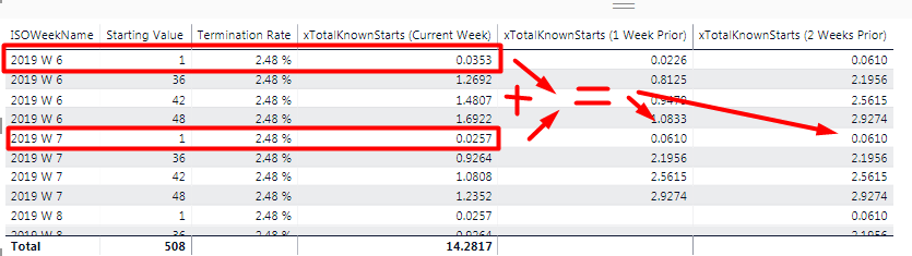

BI Table 2
As you can see, the "2 Weeks Prior" column is totally up the first week and second week's values, when it is set to capture the results for Actual Date - 14, which should ONLY be week 6 results.  Also, as you can see in the "1 Week Prior" column, some show blank altogether, though it should simply be pulling the last weeks data still, for example 2019 W 8, Shift 1, should be pulling 2019 W 7, Shift 1's values.
