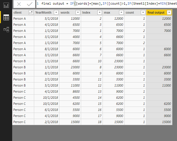

Hi @Anonymous
Create a index column from the Query Editor
Create calculated columns
max = CALCULATE(MAX([words]),ALLEXCEPT(Sheet1,Sheet1[client],Sheet1[YearMonth]))
count =
    COUNT ( Sheet1[max] ),
    FILTER (
        ALLEXCEPT ( Sheet1, Sheet1[client], Sheet1[YearMonth] ),
        EARLIER ( Sheet1[words] ) = [words]
final output =
IF (
[words] = [max],
IF (
[count] > 1,
IF ( Sheet1[Index] = MIN ( Sheet1[Index] ), Sheet1[max] ),
[max]
Best Reagrds
Maggie

Hi @Anonymous
count =
    FILTER (
final output =
IF (
[words] = [max],
IF (
[count] > 1,
[max]
Best Reagrds
Maggie
