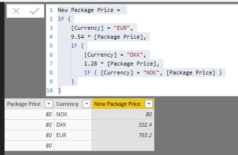

HI, @Anonymous
Try this formula to add a calculate column
New Package Price =
IF (
    [Currency] = "EUR",
    9.54 * [Package Price],
    IF (
        [Currency] = "DKK",
        1.28 * [Package Price],
        IF ( [Currency] = "NOK", [Package Price] )
16
Lin
Community Support Team _ Lin

HI, @Anonymous
There is a mistabke in your formula
Column = IF(VoucherLog[Currency]="Eur",9.54*VoucherLog[Package Price],IF(VoucherLog[Currency]="DKK",1.28*VoucherLog[Package Price],IF(VoucherLog[Currency]="NOK",VoucherLog[Currency])))
Column = IF(VoucherLog[Currency]="Eur",9.54*VoucherLog[Package Price],IF(VoucherLog[Currency]="DKK",1.28*VoucherLog[Package Price],IF(VoucherLog[Currency]="NOK",VoucherLog[Package Price])))
Note: Black body part
Lin
Change the last VoucherLog[Currency] to VoucherLog[Package Price]
