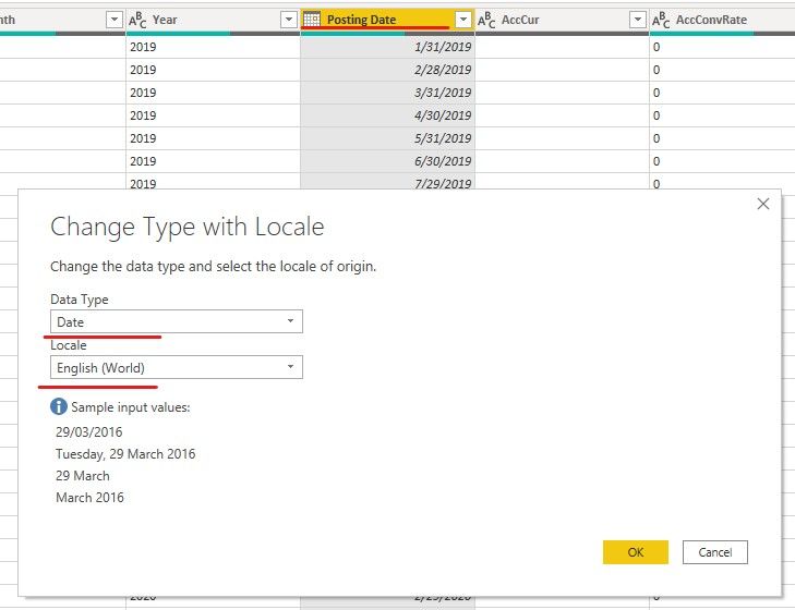

Hello @Paulyeo11 ,
Maybe the structure of your date can't change to the U.S. date.
You must right-click the date column and select Change Type -> Using Locale.
Then choose English (World).

Hi Zhen
Thank you vry much for your sharing , yes you are correct , i make a mistake to change the date to USA date , which is wrong . instead i should use UK date .
