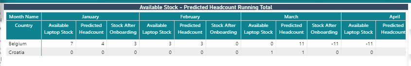

Measure only works if an unrelated column has data. (Example file Included).
For some reason a measure in a matrix will only show data in the measures column, if there is data present in another column.  As an example (file attached), for Croatia, although they have 1 laptop available and should show in the "Running Total Stock" column for Jan & Feb, it doesnt until March, when there is 1 "Predicted Headcount" entry.
How can it get it to show the stock in all months?
Find an example pbix file: Example File (Correct one now)

Sorry, i uploaded the wrong screenshot and file.  Now corrected both.  As you can see for Belgium, in Jan there are 7 Laptops and 4 new starters, leaving 3 laptops.  Then for Feb, there are 3 Laptops and 3 New Starters leaving 0 remainin laptops, and this works through the year.
For Croatia, although there is 1 laptop available, it only shows that 1 laptop once a new starter is present in March.  What it should be showing is Jan: Available 1, Headcount 0, after onboarding 1, then the same for Feb, and then in March, as it displays.
Hope that makes sense
Hi @StuartSmith ,
Your issue is regading the relationships and the wqay you have your model setup., many-to-many relationship witha filter for both sides can always bring you incorrect results, in this case I have solved making two changes to your model:
  • Create a table with coutries
  • Change the many to many to many relationship to a many to one to many using the country table has a bridge to your dimensions tables
  • Changes the filtering from both to single on the relationship between the calendar and the Dates table
  • Change the filed country on your visualizations by the new table values
  • Change your measure to :
Running_Total_Stock_After_Onboarding_Measure =
Var Reuse_and_New_Stock_Count = COUNTROWS('Reuse & New Stock') + 0
Var Total_laptop_Stock = Reuse_and_New_Stock_Count
Var Headcount_Running_Total = CALCULATE (COUNTROWS ( 'HR Data' ),FILTER ( ALLSELECTED ( Dates ), Dates[Date] < MIN( Dates[Date] ) ))
Return
 Total_Laptop_Stock - Headcount_Running_Total +0
Be aware that in this measure I have replaces the MIN that was getting the value from the HR table to the Dates table (since this is the table used on the visualization and also on the one side of the relatioship.
Final result below and in attach PBIX file:
Check this video of Marco Russo with explanation about the many to many relationship.
https://www.youtube.com/watch?v=wRSJ6TYjEu0
Regards
Miguel Félix
