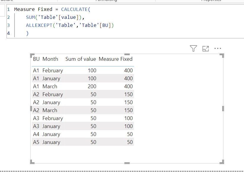

    heiavieh Please review the attached screenshot, and use the following measure to sum based on Business Unit.
    Measure Fixed = CALCULATE(
        SUM('Table'[value]),
        ALLEXCEPT('Table','Table'[BU])
    Fahad Qadir
    Did I answer your question? Mark my post as a solution! Appreciate your Kudos !!
  • You can try using ALLEXCEPT in your measure. Microsoft Learn - ALLEXCEPT
    BU Actual Total =
    CALCULATE(
        SUM('Table'[Actual]),
        ALLEXCEPT('Table', 'Table'[Business Unit])
